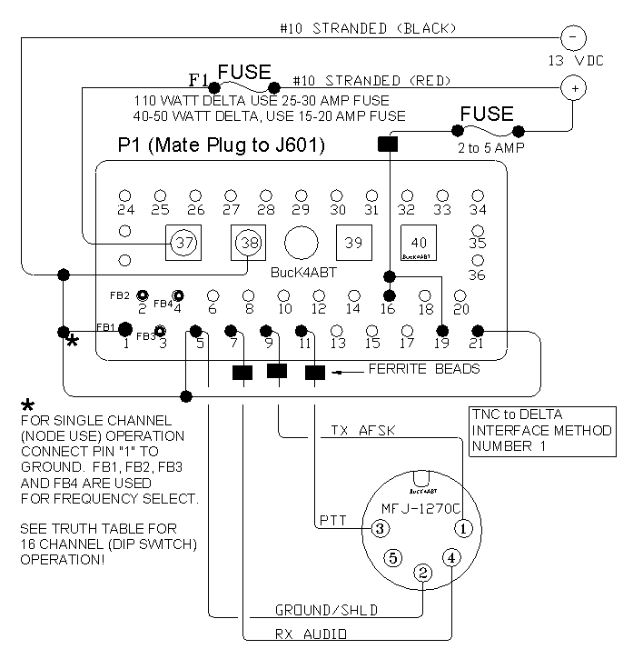

You can test the DELTA by building an interface cable similar to that shown at figure one. This connector (P1) uses (GE/ERICSSON Part number(s) (cover=19C850508P1), (connector=19D900037P1), and (housing=19D900015P1), I cannot supply these parts.

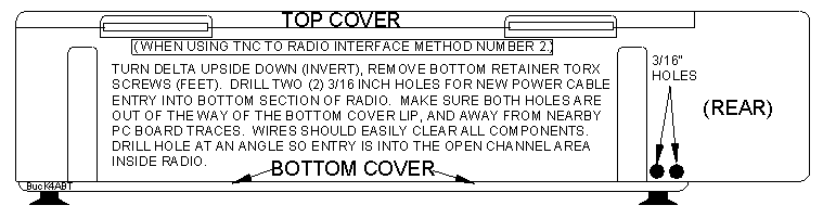

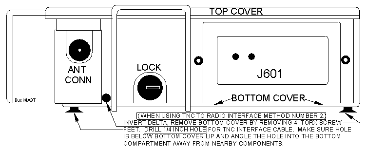

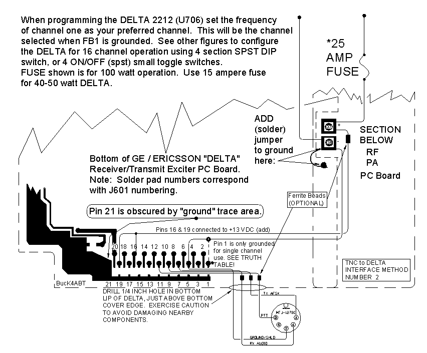

I do not use the "P1" connector; Instead I build the interface I've drawn as figure two. I do a bit of surgery to the front of the DELTA (see figure 3), and insert the TNC cable at the DELTA front. Then I make a couple of 3/16th inch holes for the DC power input wires at the rear (see figure 4).

If you know the "personality" (frequency, usually 16 channels) of the radio you are working with, you can build the simple test interface that I have drawn at figure one. Although I am showing the DELTA "P1" plug interfaced to the MFJ-1270 connector, this same plug and five pin DIN combo can easily be used to test the operability of the GE DELTA radios.
Always perform a preliminary test of the radio, and do so into a purely resistive dummy load... rated at more than the power output of the radio... e.g. 110 watts... PLUS. Just so you know... I've seen much more than 150 watts out of some of these radios!... so do beware, and remember R23.. more on the application of R23 later. While making modifications to several of the GE/ERICSSON DELTA radios, I've been able to crank as high as 175 watts of power output from them. Yes, I know... the temptation is to run the power up, but the high powered VHF DELTA radio is spec'd at 110 watts output. BUT REMEMBER, you will need a 25 to 30 ampere, 13 Volt DC supply for this high powered beast!
OK, so we are using the DELTA in the Packet radio service, so maybe I will crank it up a tad more... but not much over... a hundred and .."rty" watts. AND only because I know that in Packet Radio service, "the 110 watt DELTA will only be keyed for a few seconds at time." Let's keep in mind that if 110 watts don't get you there, then the target node or Packet station is; 1) deaf, or 2) too far away.
Here is how to maintain power control of the DELTA 110 watt radio. If the radio is running over ... let's say; 140 watts, the power can be reduced by turning R23 counter-clockwise. R23 is located in the RF PA compartment at the left side of the DELTA (component side up) radio. If the metal cover is in place on the RF PA, there will be a single hole near the right front of the RF PA cover.
Once you have the interface complete as shown in figure two, use pin 3 of the 5 pin DIN to ground to test (PTT) the transmit of the DELTA. Use a small amplifier (or earphone) attached to pin 4 of the 5 pin DIN to check the receive. As shown, the pin connection I've used to attach for TNC receive audio is "unsquelched" allowing you to hear white noise on the test speaker. The audio receive ground will be to pin 2 of the 5 pin DIN connector. This is one reason I recommend the MFJ-1270B, or C, TNC for X1J4 node service, as it will operate with radios that have "open" or unsquelched receive audio.

DEALING WITH FIGURE TWO:
An alternate method to interface the DELTA to an MFJ-1270B or C TNC is shown in figure two. This is how I interface all my DELTA to X1J4 nodes. One caveat... If you make the mod as I have, using the interface at figure 2, then be sure to cover, or use heat shrink tubing to cover pins 37, 16, and 19 on the front (J601) radio connector. The location of these pins are shown and labeled in figure one (1).
After you're confident that you have a good working DELTA, the next step is to remove power, and remove any tone (Channel Guard) board from the radio (if it has one). Toss it away.... far away, you will no longer have a use for this PCB. To remove the CG PC board, open the top of the DELTA. The "CG" PCB is located near the front of the DELTA in the left front section with the solder traces exposed or facing up. Remove the four (4) TORX retaining screws. Now lift.. that is, it may need a slight tug, to remove the CG PCB. Remove the small "extender" PCB also.
Next; Locate jumper pins J608 and J609. These pins will be directly below where the CG PC board was located. If the radio was equipped with channel guard, then a jumper (strapping option) will be present on J609. Move (remove) the jumper (P609) from pins J609 and move it left to J608. place the jumper on J608 where it becomes "P608."

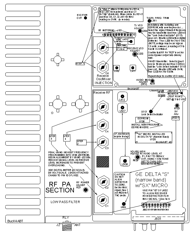

Now that we have the EEPROM programmed and installed at U706, it is time to do the final touchup to the DELTA. You may wish to make a copy of this SEDANewsLetter so you can switch between pages and text to view the next alignment procedure or test point.
I am a strong believer in, " A picture is worth 10,000 words. So to make your life easier, I have drawn an extensive overview of the DELTA radio tuning points and voltage monitoring points within the radio (see figure 5). Stop for a moment and study the drawing at figure five and the steps I have outlined. By reviewing this drawing now, may save some time later when you get into the nitty-gritty of the modification.
First and foremost, read the text box shown in the upper right corner of figure 5. This section is first because you must be sure you have frequency lock of both the DELTA receive and transmit VCO's.
It is important that you use a DVM with the readout set for the 1 to 10 volt "DC" scale.... or that the DVM will auto-range to the scale you require.

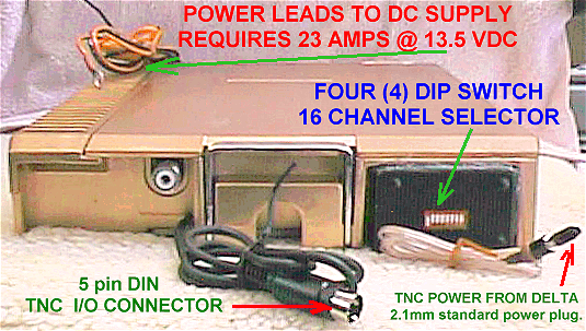

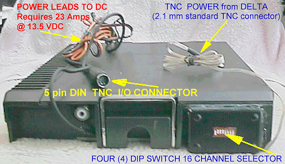

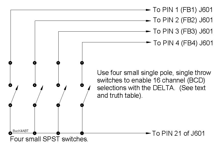

As you become more familiar with your DELTA radio, you will soon learn how easy it is to make the DELTA into a 16 channel, 110 watt Packet Radio. We've discussed the use of the DELTA as a single channel mountain top node radio, but now let's talk about utilizing the fuller potential of the Delta's sixteen channel capability.
At figure 6, I've outlined a simple BCD switching arrangement that will enable you to "switch" to any one of the sixteen channels programmed into your 2212 EEPROM (U706). In TABLE 2, I'm including the "truth table" that supports this switching arrangement.
FB1 - FB2 - FB3 - FB4
ON OFF OFF OFF
OFF ON OFF OFF
ON ON OFF OFF
OFF OFF ON OFF
ON OFF ON OFF
OFF ON ON OFF
ON ON ON OFF
OFF OFF OFF ON
ON OFF OFF ON
OFF ON OFF ON
ON ON OFF ON
OFF OFF ON ON
ON OFF ON ON
OFF ON ON ON
ON ON ON ON
OFF OFF OFF OFF
FB1, FB2, FB3, and FB4 are the pin identifiers for pins 1, 2, 3, and 4 at J601. Now that we are beginning to see the relationship between the channel numbers and the truth table, let's look at the switch configuration for the truth table and the list of frequencies that I use for Packet operation in the DELTA, shown as TABLE 3.
* CAVEAT...Frequency FB1 FB2 FB3 FB4 1. 145.770 ON OFF OFF OFF 2. 145.010 OFF ON OFF OFF 3. 145.030 ON ON OFF OFF 4. 145.050 OFF OFF ON OFF 5. 145.070 ON OFF ON OFF 6. 145.090 OFF ON ON OFF 7. 145.570 ON ON ON OFF 8. 145.610 OFF OFF OFF ON 9. 145.630 ON OFF OFF ON 10. 145.650 OFF ON OFF ON 11. 145.670 ON ON OFF ON 12. 145.690 OFF OFF ON ON 13. 145.730 ON OFF ON ON 14. 145.750 OFF ON ON ON 15.* 144.390 ON ON ON ON 16. 145.790 OFF OFF OFF OFF TABLE 3

(OPTION TWO (2) ''PHOTO ABOVE''); 110 Watt, Delta SX with 20 Db Receive Preamp installed, ready to plug-n-play; I can supply a sixteen (16) channel, modified and tested, 110 Watt, Delta SX, with 16 (two meter VHF Packet frequencies programmed into the EEPROM), using a 4 position "DIP" switch for channel selection (DIP switch position for frequency selection, table included). This includes the switch setup (see figure 6) that enables switching between any of the 16 channels programmed into the 2212. This option is ready to "plug and play, and is $150.00 dollars (THE SUPPLY IS LIMITED).

(OPTION FIVE; Photo Above) 9600 Baud, modified and tested 110 Watt, Delta SX with 20 Db Receive Preamp installed, and 16, two meter (VHF) Packet frequencies programmed into the EEPROM (4 position DIP switches are used for channel selection; Photo above). This includes the DIP switch setup (see figure 6) that enables switching between any of the 16 channels programmed into the 2212. This option is ready to "plug and play at 9600 bauds (and 1200 bauds), and is $200.00 dollars (LIMITED SUPPLY).
