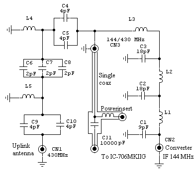

Another trick is how to use single coax line to feed uplink antenna and downlink converter with single rig like IC-706MKIIG . Look on schematic diagramm MFJ duplexer
You need to add power inserter at tranceiver side and run long coax cable to roof or tower with uplink antenna and downlink s-band converter.
