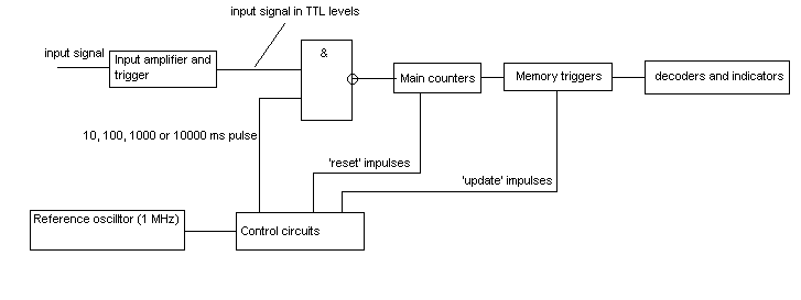

The idea of frequency measurement is quite simple - you just count the number of impulses during fixed time interval. If the time interval has length 1 second, the result will be directly in hertz. The precision is determined only by precision of time intervals, but the latter are usually formed from high-stable quartz oscillator. Typical counter consists on the following parts: reference oscillator, counter with indication, input trigger and control circuits. Reference oscillator together with control circuits forms fixed time interval as well as reset impulses for counters. The input signal passes through input amplifier and trigger, becoming the levels used by ICs. Then the impulse sequence formed goes to the 'gate', which periodically opens for precise time determined by control circuit. During this time, counters accumulate the result, which is displayed. The structure diagram of my unit is shown below:

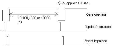

In my unit to add to all standard parts internal memory triggers are introduced to make measurements more convenient and fast. If output indicators are connected directly (trough corresponding decoders) to the counters, the digits are 'blinking' during measurement, and it is required to make additional time of indication, during which counters are idle. This reduces the ease of readout and speed of measurement. If there is internal memory, you can make counters working almost all the time and update the information on indicators only after the cycle of counting is done. During the cycle the previous result is shown. To implement this principle, the control circuit forms impulses for the gate opening (length 10, 100, 1000 or 10000 ms depending on the position of the switch), for counters reset and for the opening of memory triggers for writing. After the counting time is finished, the information in triggers is updated by short pulse, and then counters are reset. The time diagram is following:
The time between measurements (~100 ms) is chosen from the following considerations: if it is too short, on short measurement times the frequency of display updating becomes too high (up to 100 Hz), which is too inconvenient for eyes. By the the value chosen here the maximum frequency of display updating is limited by 10 Hz, which is good enough from viewpoints of service and measurement speed.

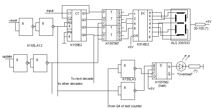

Main counter board
Main counter has 6 identical decades. Each decade consists on counter (K155IE2), memory triggers (four triggers in one K155TM7 chip), decoders for transformation four-bit code into code required by 7-segment indicators (K514ID2) and LED indicator (ALS335B). All reset inputs of counters are combined together, the same is done with C-inputs of triggers. To avoid difficulties in driving so many inputs simultaneously by an external signal, a powerful repeaters made from two inverters (K155LA12 chips) are introduced onto 'reset' and 'update' inputs of the block. To add to this, main counter board has a circuit for controlling the 'overload' LED, which is turned on in case of counter overloading. The principal circuit (excluding pin numbers, sorry!!) is here:
The schematics here is quite straightforward: there are 6 identical decades (only one is shown on the picture), which are connected in series. From the last output (Q4) of the last counter the signal goes to the overload control circuit. The latter consists on two inverters, D-trigger and LED indicator.
If the total number of impulses counted during counting time exceed 999999, the level on the Q4 of last counter changes from 1 to 0. After the inverter, on the C input of trigger, it becomes be changing from 0 to 1 (rising). This makes the dynamical trigger to set the signal on its output according to potential on D input, which is constantly 5 V (logical 1). After the trigger is set, LED becomes to emit the light showing the overloading. The next reset impulse, after passing through inverter resets the trigger into previous state by means of R (inverted) input. Practically all the above means, that in case of overloading the LED is blinking in tact with measurement cycle.

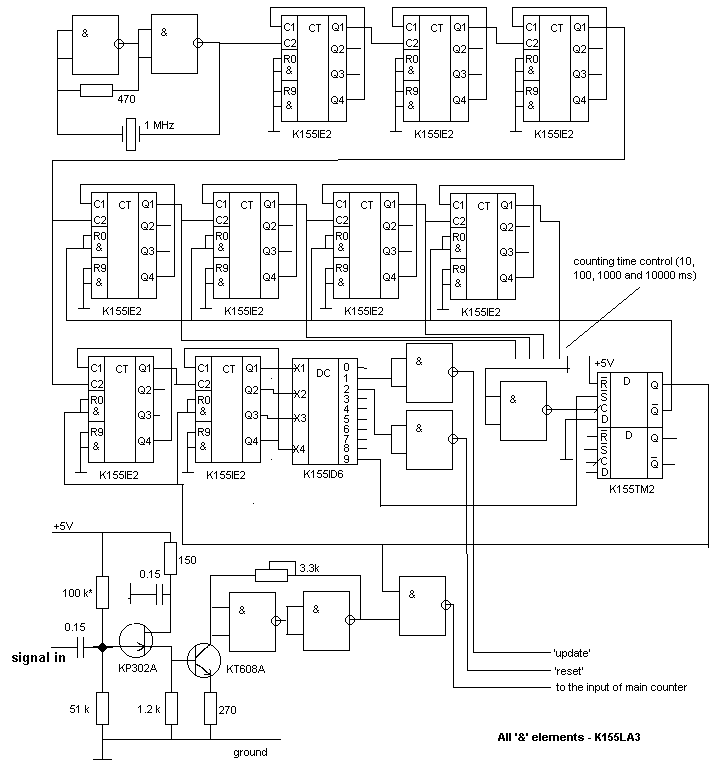

Control device with input circuits and reference oscillator
This is the main one and the most complicated block in the whole construction. It performs the task of formation of 'update' and 'reset' impulses for the main counter board, as well as gate opening impulses. Also here the input signal of any wave form is converted into the TTL levels pulses for further digital treatment.
The 'heart' of digital frequency counter, which determines its precision is reference quartz oscillator. In the unit described here it is made on two inverters (155LA3) with the positive feedback on 1 MHz quartz crystal. If the actual frequency is not exactly 1 MHz, which is quite common situation due to crystal's parameters deviation and affecting of external capacities, additional small inductor or capacitor in series with resonator may be introduced to correct the situation.
1 MHz signal then passes through the chain of 1:10 dividers (3 K155IE2) becoming the frequency 1 KHz. This signal is routed to two chains of counters. The first one, consisting on 4 decades, is designed for the formation of gate opening impulses. After the specified number (10, 100, 1000 or 10000, depending on the position on the switch) is accumulated in these counters, the D-trigger is set in 'zero' state through its C-input. This causes high potential on the trigger's inverted output, which is connected with the reset inputs of all four counters and they stop to work for a while. The direct output of the trigger (Q) drives the gate (third from left &-element on the bottom of the scheme). After the trigger is set in 'zero', gate closes, and simultaneously another chain consisting from two counters start to count 1 KHz impulses. The last counter in this chain is followed by "4 to10" decoder (K155ID6). After 10 impulses, signal on the '1' output of the latter becomes zero for a short time. After passing through inverter it is used for updating information on the display. By the same way the output '2' of the decoder is used to form the 'reset' impulses for main counter board. After about 100 ms from the moment of gate closing the signal on the '9' output of the decoder becomes zero, causing setting the D-trigger in the 'on' state. At this point the second chain of counters stops working, the gate opens again, and the cycle repeats.
The input amplifier and trigger is made on two transistors - one junction FET and one bipolar and the trigger on two inverters. The resistor marked by a star, as well as a semi-variable resistor are chosen to provide the best sensitivity and stability of working. Though this circuits looks quite primitive, it has very flat frequency response, which is incredible difficult to achieve in complicated amplifiers, and reasonable sensitivity - about 150 mV in range from 100 Hz to 30-32 MHz. I tried many other circuits, but the results were much worse.
