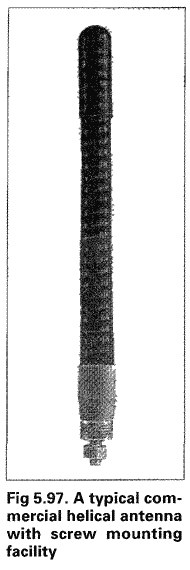

Much has been said for and against what is termed the
normal-mode helix as used on hand-held transceivers. Unfortunately the method of operation and the results obtainable for this type of antenna have been much misunderstood by amateurs and professionals
alike. Most theoretical papers only consider the helical equivalent of the
Lambda/4 whip while most users of this antenna are in fact using the equivalent of a physically reduced 3Lambda/4
whip.
A helix will work in the normal mode when the diameter and pitch of the helix is less than 0.1 Lambda When working in this mode the radiation is from the side of the helix, and when the diameter is considerably less than 0.1? the resultant 'spring' has a radiation pattern similar to a short vertical monopole or whip.

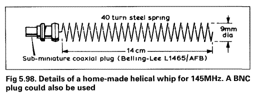

at the extremities. Under typical hand-held conditions, however, and depending on the frequency of operation, the spring tends to be fairly close to a 50Q impedance match. This is shown in Fig 5.98 which also gives an indication of the number of turns required for a typical 9mm diameter helix for 3'k/4 resonance.

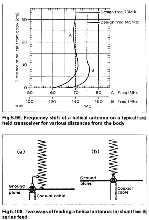

The helical or spring has an interesting and difficult operating characteristic when supported close to the
body, particularly at the higher frequencies. Fig 5.99 shows the typical results of a 145MHz or high-band spring and a 70MHz or low-band spring as it is brought closer to the
body. The interesting effect which occurs at several centimetres from the body can be
seen, where the resonance of the spring, instead of continuing to decrease due to body
capacitance, suddenly increases the frequency of resonance. At 2cm and closer the operating frequency suddenly decreased due to body
capacitance. Unfortunately this very changeable area occurs at the typical mounting distance of a body-worn
transceiver. However, many transceivers are required to be raised to the mouth when transmitting and this puts the antenna back to its best operating
conditions.
