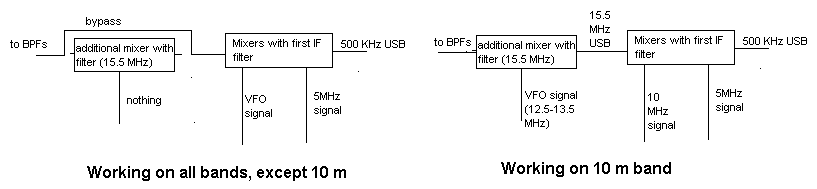

If you retain the main schematics of the transceiver, there is only one way to decrease required frequency of VFO on 10 meters band - to increase the first IF. But the second IF at 500 KHz does not allow to do it - if you increase the first IF, say up to 10 MHz, the mirror selectivity at second IF becomes too poor. The solution is:to introduce the THIRD IF, and the third bi-directional frequency converter. The good value that i used, is 15.5 MHz. In this case, VFO frequency at 10 m band becomes shifted down from the original value for 10 MHz and becomes 12.500 MHz at 28 MHz reception, which is quite acceptable from all viewpoints. Additional frequency converter uses 10 MHz LO signal to convert 15.5 MHz to 5.5 MHz, which is first IF in original unit. This LO frequency is obtained from a stable quartz-oscillator. When divided by factor of 2, this signal (5 MHz) can be used for the next mixer. This does not add any additional oscillator to the unit, which is quite good from a viewpoint of internal interference.
The implementation of this idea is rather simple. you make the bi-directional frequency converter on two JFETs according to the schematics of transceiver's mixers. Between it and the former first mixer you set the BPF tuned to 15.5 MHz. This converter works only on 10 meters and on others bands is bypassed. You also replace the original 5 MHz oscillator to 10 MHz and add a 2:1 divider with subsequent emitter repeater. The signals of LO's are appropriately directed on all bands by additional relays. The block schematics is here:
So, we have double frequency conversion transceiver on 160-15 m, and triple frequency conversion transceiver on 10 meters. The construction i implemented here does not cause signifcal gain change by introducing additional conversion stage, and the rig works as good as before on 10 meters, but with much improved frequency stability on this band.

10 MHz signal should be connected through half-sinewave former (on diode and 1k resistor) to the 'C' input of a flip-flop clock SN7474, which works in counting mode (inverted output and 'D' input are connected to each other). The IC is fed like counter in original block - trough resistor from a main source (about 510 Ohm). The output of clock is directly connected to the input of original counter, as well as to conventional emitter-repeater with LC-low pass filter. After all changes are done, this block supplies 10 MHz, 5 MHz and 500 KHz signals.
The main one. You make additional bi-directional frequency converter with the design similar to the original two ones. As a BPF for 15.5 MHz serve three resonant circuits with inductive and capacitive connection. Inductors are wound on 6 mm polystyrene core with a ferrite slug and have 75 pF capacitors in parallel, and 6.8 pF capacitors for the connection between circuits. The physical distance between coils - about 25-27 mm. Additional relays should also be introduced, which provide bypassing of the signal on 160-15m, as well as proper LO's signal switching (see scheme above).
After all is done and BPF's are tuned, the rig on 160-15m should work without any changes, and on 10 meters the same gain as before should be provided. But the frequency must be much stable.
This variant gives slightly higher stability due to lower VFO frequency, but it suffers from following disadvantages: receiveing becomes too 'dirty' due to many points of heterodyne interference, because the digital divider 10 -> 5 MHz, used in LO gives a lot of harmonics at the output. Also, in TX mode on 10 meters, as it appeared, parasite emission exists on 31 MHz. This is the second harmonic of last intermediate frequency, which is not suppressed adequately by the BPFs, because it is too close to the passband. I could not decrease its intensity to appropriate limits.
