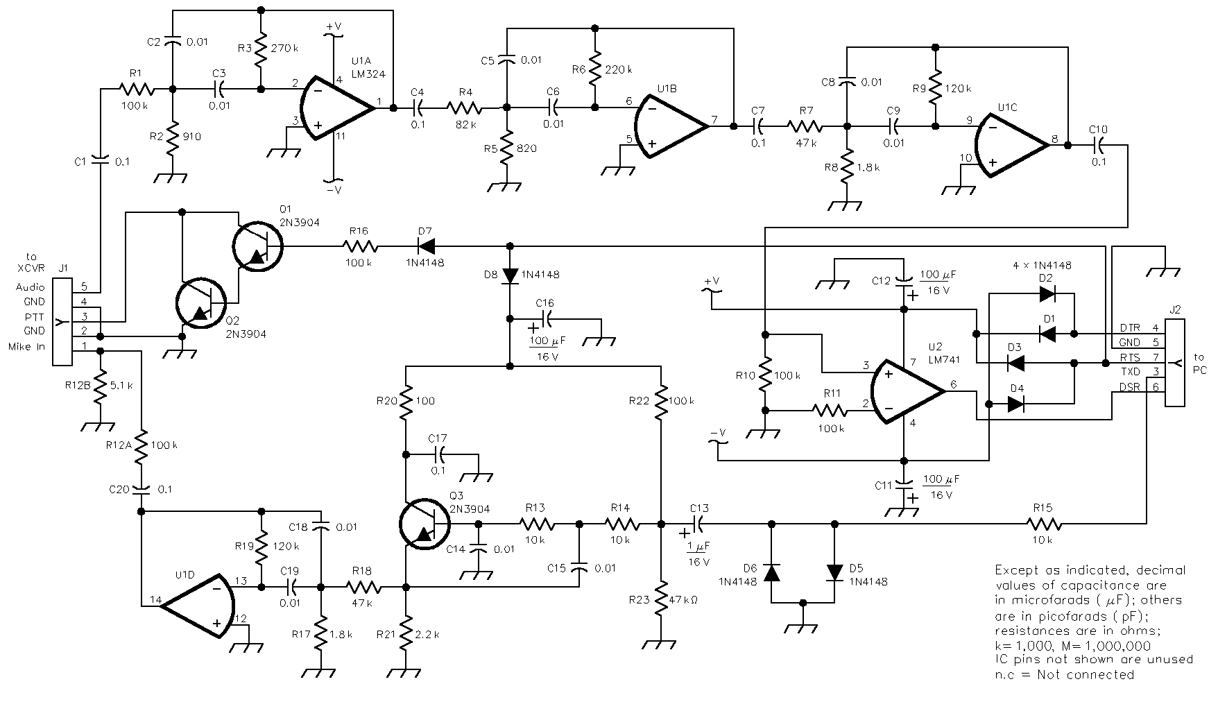

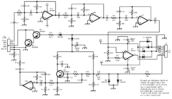

Circuit Description

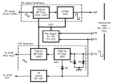

See Figures 1 and 2. VolksRTTY is comprised of four functional elements: power supply, received-signal conditioner, FSK generator and TR switch. Let’s trace the signal flow through each stage before proceeding with the construction details.
Figure 1—Simplified block diagram of the VolksRTTY interface.

Figure 2—Schematic of the VolksRTTY modem.
Unless otherwise specified, resistors are 1/4 W, 5% tolerance carbon-composition or film units. Part numbers in parentheses are Jameco; equivalent parts can be substituted. Jameco Electronic Components, 1355 Shoreway Rd, Belmont, CA 94002; tel 800-831-4242, 650-592-8097; domestic fax 800-237-6948, 650-592-2503; international fax 650-592-2503; e-mail info@jameco.com; http://www.jameco.com
C1, C4, C7, C10, C17, C20—0.1 mF, 50 V (135562)
C2, C3, C5, C6, C8, C9, C14, C15, C18, C19—0.01 mF, 50 V (26884)
C11,C12,C16—100 mF, 16 V (94289)
C13—1 mF, 16 V (94160)
D1-D8, 1N4148 (36038) (ëþáûå ìàëîìîùíûå êðåìíèåâûå äèîäû, íàïðèìåð ÊÄ503 è ò.ä.Ïðèì.UN7GM)
J1—5-pin PC-mount DIN connector (29399)
J2—9-pin PC-mount female connector (104951, DE9S318)
P1—5-pin DIN plug; mates with J1 (15878)
Q1-Q3—2N3904 or 2N2222A (38359) (ïîäîéäóò ìàëîìîùí. npn òðàíçèñòîðû, íàïðèìåð ÊÒ342.Ïðèì.UN7GM)
U1—LM324 (23683) (àíàëîã Ê1402ÓÄ2À.Ïðèì.UN7GM)
U2—LM741 (24539) (àíàëîã Ê140ÓÄ708.Ïðèì.UN7GM)
Misc: IC sockets, hardware, 6-foot-long, 9-conductor cable with DE09 male/DE09 female connectors, mates with J2 (25700, monitor extension cable); 4.9 x 2.5 x 1.5-inch (LWD) plastic enclosure (18913); see text.
Power Supply
Depending on their logical state, the active pins of the serial port assume a nominal -10 V or +10 V level. Most IBM-compatible PCs can source about 5 mA from each of these pins before the voltage starts to sag. VolksRTTY derives its plus and minus operating voltages from the DTR and RTS pins using diodes D1 through D4 with smoothing provided by C11 and C12. During receive, DTR outputs +10 V and RTS -10 V. During transmit, DTR outputs an asymmetrical square wave corresponding to the mark/space state, while RTS goes high to turn on the TR switch. To provide operating voltages in either mode, the four diodes are cross-connected as a bridge rectifier. This simple configuration provides plus and minus rail voltages of 7 to 10 V under load, a range that is compatible with standard RS-232 levels.
RX Signal Conditioner
During receive, the station transceiver is tuned to an RTTY signal so that the mark and space audio tones (assuming 170 Hz shift) presented to the interface are nominally 1015 Hz and 1185 Hz, respectively. These tones are passed through an 1100 Hz active band-pass filter comprised of three sections of an LM324, U1. The center frequencies and Qs of each stage are staggered to provide a filter response that is flat within 3 dB over a 275 Hz bandwidth. [2] Filtered mark and space tones are applied to limiter U2, which converts the tones to square waves of the same frequency. These are applied to the serial port’s DSR pin for processing by HamComm. Software FSK detection is accomplished by measuring the period between low and high transitions. Because frequency is inversely related to period, it is a simple matter (conceptually, at least) for the software to determine whether a mark or space tone is being received.
Sharp-eyed readers may note an apparent inconsistency here: The circuit takes an analog input, performs some filtering and signal conditioning, and applies it to a serial port pin as a digital output. Where did the A/D conversion occur? In U2. A 741 op amp running open-loop for maximum gain, U2 effectively acts as a 1-bit A/D converter. Depending on the state of the limiter, its output will closely approach one of the 741’s positive or negative rail voltages. Because these voltages are compatible with RS-232-C levels, the output of the limiter is also compatible.
TR Switch
During transmit, HamComm causes the RTS line to go positive. This voltage turns on Darlington pair Q1/Q2 to pull the transceiver’s PTT line low. That switches the transceiver from receive to transmit. Operating voltage for low-pass filter Q3 is derived from the RTS line as well.
FSK Generator
HamComm tells the hardware to output a square wave on the TxD line at a frequency equal to the desired AFSK tone: either 1015 or 1185 Hz, depending on whether a mark or space is being transmitted. This square wave is clipped by D5 and D6, then applied to low-pass filter Q3 and band-pass filter U1D. The two filters attenuate the odd-order harmonics and ensure that a reasonably clean sinusoidal waveform is applied to the transceiver’s microphone input.
HamComm’s choice of mark and space frequencies is a compromise. Initially, I used a center frequency of 700 Hz reasoning that the lower frequency would make it easier to achieve the desired receive-filter band-pass characteristics. During tests, it became apparent that the FSK generator did not provide sufficient attenuation of the third harmonic of the square wave input. This harmonic manifested itself as a spurious FSK signal during transmit which, although barely discernible, had the potential to interfere with other QSOs. After considerable experimentation directed toward improving the harmonic attenuation, I finally threw in the towel and moved the center frequency to 1100 Hz. This puts the weak third harmonic pair at 3045/3355 Hz, which is sufficiently outside the band-pass of a modern SSB transceiver’s filter to ensure a clean signal.

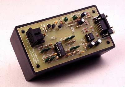

Construction
VolksRTTY can be built on a PC board, perf board with point-to-point wiring, or even "dead-bug" style (see Note [1]). Neither lead length nor component layout seems to be particularly critical. My interface was initially installed in a plastic box, as shown in the photograph. With a transmitted power output of 400 W on 40 and 20 meters, I had no problems with RF feedback. Later, after changing antennas, I did encounter some difficulty when operating on the higher bands. Since then, I’ve packaged the interface in an aluminum enclosure, and the RF problems have disappeared.
Pay close attention to the values and tolerances of the resistors and capacitors associated with U1A through U1D: Use the values specified, ideally with 5% or better tolerances. With the exception of the 0.1-mF coupling capacitors, these components establish the passband characteristics of the 1100 Hz band-pass filters.
The 0.01 mF capacitors called for in the parts list are specified by the distributor as 10% tolerance components. My experience with several hundred of these capacitors is that nine out of ten are within 3% of their nominal value. If you have a means of accurately measuring their values, install those with the greatest capacitance in stage U1A and those with the lowest capacitance in stage U1B. Use the ones closest to nominal in stages U1C and U1D. This approach broadens the filter response curve a bit and makes it flatter. If the capacitors are randomly selected, there is a tendency for the tolerance build-up to cause the filter bandwidth to be somewhat less than the design target of 275 Hz. If you aren’t able to measure the capacitor values, don’t be concerned—the impact on operational performance is quite modest, providing you use capacitors that are within a few percent of the specified value.
Avoid the temptation to replace the specified op amps with hotter devices—at least until you get the circuit working with those called for in the parts list. This is because many devices with greater gain-bandwidth products also have healthier appetites for power supply current. The excessive current draw causes VolksRTTY’s rail voltages to sag, and the circuit ceases to operate.

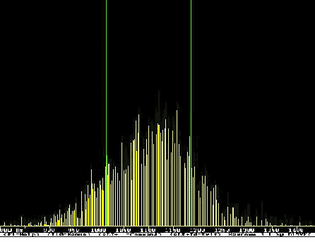

Set your transceiver to the USB mode, turn off any audio filters your transceiver may have and tune to a clear spot in the band. [3] Press F7 on your keyboard, and HamComm will bring up the "spectrum analyzer" tuning indicator. With the receiver’s audio gain set at a normal listening level, you should see a display similar to that shown in Figure 3. If you want, the display can be expanded by pressing PG UP several times and then recentering the display with the arrow keys.
Figure 3—HamComm’s "spectrum analyzer" tuning indicator with no signal present.
The two vertical lines in Figure 3 correspond to the frequencies at which Ham-Comm expects the mark and space tones to occur. The shape of the noise spectra corresponds roughly to the filter response in the VolksRTTY interface. If your noise spectra looks like that of Figure 3, the band-pass filter is working as intended. If the spectra looks significantly different, check the wiring and components associated with U1A, U1B and U1C.

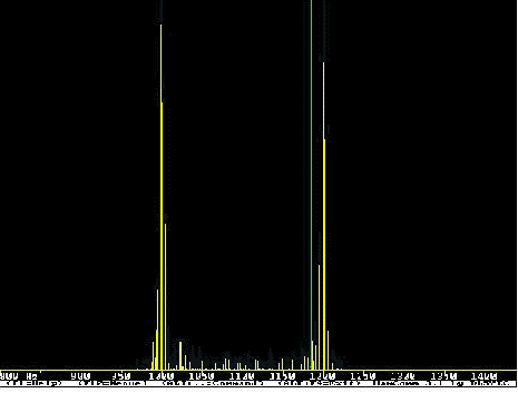

Once you have confirmed that the filter is functioning properly, set your transceiver to USB with an IF filter bandwidth of 2.7 kHz or so and tune around until you locate a strong RTTY signal. Adjust your transceiver’s main tuning until you see a spectrum analyzer display similar to the one shown in Figure 4.
Figure 4—HamComm display of a properly tuned RTTY signal.
Your objective is to line-up the mark/space spectral lines of the RTTY signal with the vertical tuning lines. Once that is accomplished, press F3 to return to the TX/RX window in baudot RTTY mode and observe the characters being printed out. You should see signs of intelligence. In the presence of severe QRM, QRN and/or QSB, some of the characters may be corrupted. This can be minimized by selecting a narrower IF filter, if your transceiver is equipped with one. Because the bandwidth of a 45 baud RTTY signal is about 250 Hz, you don’t want to use a filter that is narrower than that. Unlike SSB voice—which requires different sideband settings depending upon the band selected—with RTTY you can always use the same sideband and RTTY polarity. If you don’t see recognizable text, confirm that HamComm is set to RTTY, 45 Baud, 170 Hz shift, and the appropriate polarity for your choice of sidebands. This is done by selecting the appropriate pull-down menus from the top of the screen using your mouse or by simultaneously pressing the ALT key and the first letter of the menu name.

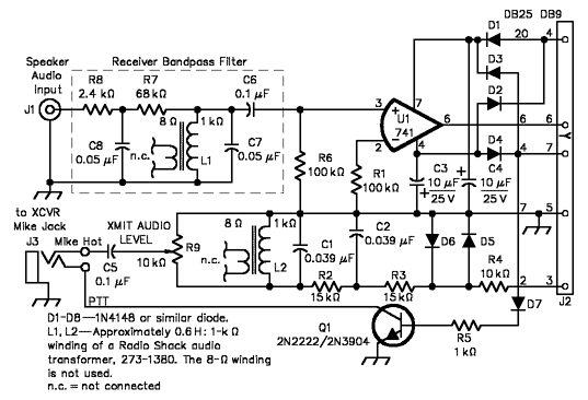

• Donald Cox, AA3EK, author of “Explore HF/VHF Digital and Image Modes on the Cheap,” implies that HamComm software is not suitable for serious RTTY and AMTOR operating. [1] As one who uses this splendid piece of shareware on a daily basis for ragchewing, DXing and contest work, I was more than a little surprised by the tone of the article. Clearly, the author does not appreciate that the performance shortcomings of the basic interface presented in his article prevents the software from even approaching its full performance potential.
In the receive mode, the basic interface consists only of a limiter—its primary function is to convert the sinusoidal mark and space receive audio tones into a square wave whose period can be measured by the HamComm software. One of the properties of any limiter is that it is captured by the strongest signal in its passband. For best performance, it is essential that the limiter be allowed to see only the desired signal while atmospheric noise and QRM are minimized. This can be accomplished by restricting the audio bandwidth presented to the limiter to that of the desired signal’s spectrum—around 250 Hz for 45.5 baud RTTY and 300 Hz for AMTOR. This input filtering allows all (or most) of the desired signal to be passed while undesired signals and noise are attenuated.
In the absence of any audio input filtering (the case with the basic interface), the signal bandwidth presented to HamComm’s limiter is largely determined by the transceiver IF filter—typically 2.4 to 2.7 kHz when operating in the SSB mode. The resultant signal to noise ratio (S/N) is at around 10 dB poorer (10 log 2400/250 in the case of RTTY) than it would be with an optimum filter. In the presence of QRM, the S/N may be degraded by considerably more than 10 dB. While 10 dB may not sound like much, with RTTY it is the difference between relatively solid print and line after line of garble.
With an appropriate audio filter ahead of the limiter, however, HamComm’s performance is just short of amazing. I use a homebrew 6th-order active filter centered at 700 Hz with a -3 dB bandwidth of 250 Hz. The resonant frequency of each of the three filter sections is staggered such that the passband is flat within 1 dB or so, and the 3/30 dB shape factor is around 3. Using this filter, I have repeatedly tuned into the middle of contest pileups with HamComm and perfectly printed a single station whose mark and space tones could not be discerned by ear in the QRM. Not bad for the $45 or so I have in the Ham-Comm registration payment and parts cost for the interface.
For those of you who try HamComm with the basic interface and find that you enjoy the digital modes, there are alternatives to plunking down several days of your hard-earned pay for a multimode TNC. First, if you have a 400 or 500 Hz IF filter in your transceiver that can be switched in while in the SSB mode, by all means use it. You can also use that old commercial CW audio filter that has been gathering dust in the corner of the shack, or if you are fortunate enough to own a DSP-based audio filter, you’re well on your way to RTTY DXCC.
If you have neither of these, try the “Basic+” enhancement shown in Figure 1. The parts are readily available from your junkbox or the local Radio Shack store. Make sure that you reset HamComm’s default 1360-Hz center frequency to the 1100-Hz frequency of the filter. Bandwidth at the -3 dB points is around 600 Hz, and although the skirts fall off in a rather leisurely manner, this simple filter provides a noticeable improvement in HamComm’s performance.
Figure 1—Schematic of an improved HamComm interface showing added components and component value changes.
There are a couple of potential pitfalls with the basic interface that can cause you to inadvertently transmit two or more sets of mark and space frequencies. I publish a Web page called K7SZL’s Unofficial HamComm Home Page that presents ways to avoid this problem, as well as other information that will help you get the most out of the program. It also offers a copy of HamComm V3.1 for download. The URL is http//www.accessone.com/~tmayhan.

Author Donald Cox, AA3EK, replies
I agree that the simple interface does not fully exploit the capabilities of the program. The interface shown in my article was selected from several in the HamComm documentation given the focus on inexpensive and simple ways beginners could try out digital and image modes.
