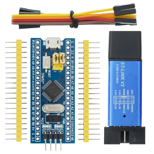

    uSDX
    DC 3V-5V 5351 Si5351A Si5351 I2C Clock 8 -160 Arduino
    ST LINK Stlink ST-Link V2 Mini STM8 STM32 A41, 1 .
    ramil_old; 16.07.2022 13:34.

    1) DC 3V-5V 5351 Si5351A 2) uSDX
    1. -120 20-30
    2. - 100 , 10
    FT8 14,074 MHz
