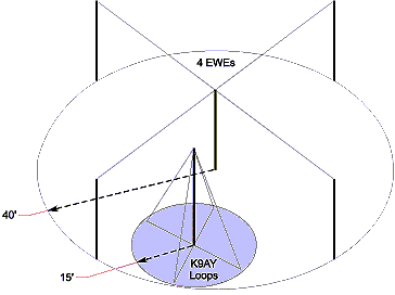

Allow me to introduce you to the terminated loop, a concept that further shrinks the space required for a good receiving antenna without sacrificing performance! Figure 1 compares the real estate requirements of my four-direction loop system to that of an equivalent EWE array. The new system is not only smaller, it’s easier to install, needing only one support instead of five.
Figure 1—A comparison of the real estate needed for four EWEs and the K9AY Loop system shows that the loops need only 1/7 the area of the EWEs, yet they provide the same directional patterns.

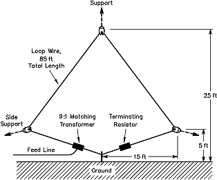

The terminated loop (see Figure 2) is physically and electrically quite simple. It consists of a wire loop of any convenient shape (diamond, delta, etc), hung from a single support and with a ground rod at the bottom. A 9:1 impedance-matching transformer connects from one end of the loop to ground; a terminating resistor connects the other end of the loop to ground. This antenna is directional, favoring signals arriving from the feed point end, rejecting by several S units any signals arriving from the end connected to the terminating resistor, RTERM.
Figure 2—The basic design of a single loop in an easy-to-construct quasi-delta loop configuration. Exchanging the feed point and termination reverses the pattern. A four-direction system uses two of these loops installed at right angles to one another (as shown in Figure 1) and a relay controlled switching system.
Here’s the real news: A very small terminated loop maintains its directional pattern. As the loop’s size gets smaller, however, the desired signal strength is also reduced. The antenna described here is small enough to fit into a corner of almost any backyard. The loop could be made smaller, but I wanted to collect enough signal energy so that even a modest preamp (such as those included in most HF rigs) can be used. More information on the antenna’s operation can be found in the sidebars “How Does the Terminated Loop Work?” and “Summary of Characteristics.”
To cover all directions, two loops using the same support are oriented at right angles to each other. Each loop provides reception from two directions when the feed point and termination are reversed, for a total of four separate patterns. Here are all the details you need to build the K9AY Loop antenna system, including a relay-controlled pattern-switching system that uses the coaxial feed line to carry the switching system control voltage.

• Two lengths of wire about 85 feet each. Although almost any wire size will do, #14 copper is probably the best for a long-lasting installation.
• Ten simple insulators—anything from old toothbrush handles to fancy porcelain insulators will do.
• A three or four-foot length of copper pipe—the ground rod doesn’t need to be driven deeply—a depth of three to four feet is sufficient. Because copper-plated steel rods eventually rust, I prefer to use 1/2 or 3/4-inch-diameter copper water pipe.
• One support 25 feet above ground—my antenna hangs from a limb of a Georgia Pine, but anything that gets the top of the loops up about 25 feet will work. The wooden A frame support described in The ARRL Handbook and Antenna Book is an excellent choice. A metal mast can be used, but make it only as long as necessary and insulate it from ground. Large metal objects affect the antenna’s performance, so install it in the clear.
• You’ll also need some rope—nothing fancy, just something strong enough to keep things in place.
Now, grab your tools and head for the backyard. Attach the midpoint of each wire length to an insulator that will be positioned at the top of the loop. The two loops must not touch each other, so leave some room between their insulators. I separated my insulators with about a foot of rope.

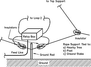

Aligned directly under the tops of the loops, drive a ground rod, leaving a foot or so above ground as an attachment point. Using short ropes or wires, connect four insulators a few inches away from this post to receive the lower ends of the loops. Leave a foot of wire for a pigtail after twisting the ends of the loop wires around the insulators. Figure 3 sketches the important installation details, and the photo of Figure 4 shows how my system is installed.
Figure 3—Construction details of a terminated loop, showing the base connections and corner supports of one of the loops. The relay box also houses the 9:1 matching transformer.

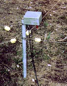

Figure 4—A photo of the central connection point at the base of a two-loop system, as installed at K9AY.
The lower corners of the loops are supported by insulators and ropes tied off to nearby trees, fence posts, or stakes driven into the ground. Pull out the corners with enough tension to maintain the loop shapes. At this point, the major mechanical work is finished and you should have something resembling an eggbeater, as shown in Figure 1.

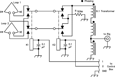

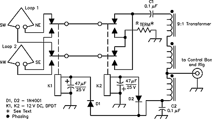

Figure 5 shows the relay circuit used to switch the feed and termination points of the loop wires. House the components in a weatherproof box having external connection points for the four ends of the loops, a coax connector for the feed line and a ground-wire attachment.
Figure 5—Schematic of the relay box located at the base of the system. The relays switch between the two loops, reversing the feed point and termination connections.
K1 is a DPDT relay that switches between the two loops. K2, another DPDT relay, swaps the connections of the terminating resistor and matching transformer, thereby reversing the pattern. Relay power is supplied via the coaxial feed line. C1 keeps the control voltage from reaching the antenna, and C2 provides an RF ground for the transformer.
Most builders will likely choose to orient the loops for northeast/southwest and northwest/southeast directions. The relay box has four switching modes, one for each direction: 1) northeast, when neither relay is energized; 2) southeast, when K1 only is energized; 3) southwest, when K2 only is energized and 4) northwest, when both relays are energized. Switching is accomplished using a single power connection through steering diodes D1 and D2. D1 allows K1 to operate when +12 V is applied, while D2 blocks the voltage from reaching K2. When -12 V is applied, K2 operates, but not K1. When 12 V ac is applied, the diodes rectify it to operate both relays.
The matching transformer is a 9:1 impedance, 3:1 turns ratio type that should be familiar to many readers. Five trifilar turns of ordinary hookup wire are wound on a 3/4 -inch-diameter (0.825 inch) 43 material toroid. The terminating resistor (RTERM) value will be between 390 to 560 W, depending on your band preference. With average ground conductivity, a value of 390 W provides the optimum F/B at 160 meters, while 560 W optimizes the loops for 80 meters. A value of 470 W splits the difference for “pretty good” performance on both bands. I chose to optimize the antenna for 160 meter operation, so used a 390 W resistor. Use an RTERM power rating of at least 1 W in case some transmitter power ends up being coupled to the loops. I use a 2-W carbon resistor, but two parallel 1/2-W or four 1/4-W units of appropriate ohmic value can also be substituted.

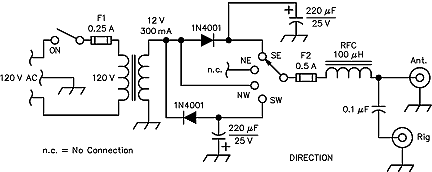

Figure 6 is a diagram of the control box that is located in the shack. One 12 V ac transformer provides the ac relay power and feeds two half-wave rectifiers and filter capacitors to generate ±12 V. One SP4T switch selects the proper voltage to apply to the coax. The RF choke and 0.1 mF capacitor keep the RF and control voltage separated at the shack end.
Figure 6—Schematic of the control box located in the shack. The control voltage to operate the relays is delivered via the coaxial line.
Once the control unit and relay box are built and operating properly, mount the relay box at the ground rod and connect the four ends of the loops to their proper terminals. A length of 50 W coax carries the signal and power between the antenna and the switch box in the shack. I highly recommend keeping the coax on the ground (buried is better) to minimize pickup of noise or energy coupled from your transmit antenna. A receiving preamplifier is almost certainly needed, either your rig’s internal preamp or an external preamp.

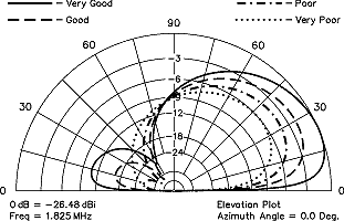

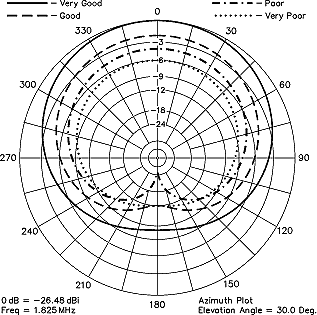

The vertical pattern of the antenna, in line with the loop, is shown in Figure 7. Figure 8 is the azimuth pattern at 30° elevation. Modeling was done using W7EL’s EZNEC program, which uses NEC-2 to evaluate the antenna over “real” ground. [3, 4] Listening tests confirm that these modeled patterns are close to the as-built antenna performance. Much of the on-air pattern evaluation was done by listening to AM broadcast stations and to WWV on 2.5 MHz, because the pattern of the antenna changes little over this frequency range. Stations at exactly the right distance and directions have verified the deep null off the back. For example, New York City area radio stations are exactly in line with my northeast/southwest loop, and show 40 dB F/B ratio when the arrival angle is just right!
Figure 7—Vertical radiation pattern of the loops along the plane of the loop.
Figure 8—Horizontal radiation pattern of the loops at 30° elevation.
The front of the pattern is quite broad, with maybe one S unit F/S. The advantage of this antenna is its rearward null, which reduces local noise and distant QRM. I installed my system just 21/2 weeks before the 1996 ARRL 160 Meter Contest, so it got a thorough evaluation in a short time. During the contest, changing the pattern direction often made the difference between Q5 copy and a busted contact. For example, pointing southeast to hear Caribbean stations reduced stateside QRM by 2 or 3 S units, enough to easily hear the DX through unruly pileups.

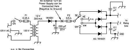

There is one problem that needs to be addressed. When the loops are switched to the northwest direction, an ac voltage is sent down the coax to the relay box. A few hams have reported hum or distortion when the antenna is switched in this direction. Two explanations are possible: a ground loop due to widely separated antenna and station grounds, or modulation of the core of the matching transformer. The presence of hum was not evident in my prototype, but to avoid either cause of the problem, I recommend using a separate three-conductor control wire to operate the relays. The power is solely 12 V dc, and no current flows through the transformer. The modifications are shown in the accompanying figures, which can replace Figures 5 and 6 in the original article.
Figure 1—A revision of the schematic shown in Figure 5 of the September 1997 QST article.
Figure 2—Changes to Figure 6 of the original article.
Secondary benefits of this arrangement include the option of using an existing 12 V power supply to provide the operating voltage, and the ability to use an additional conductor to carry power to an antenna-mounted preamplifier.
