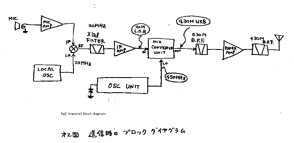

2. General construction of this transceiver

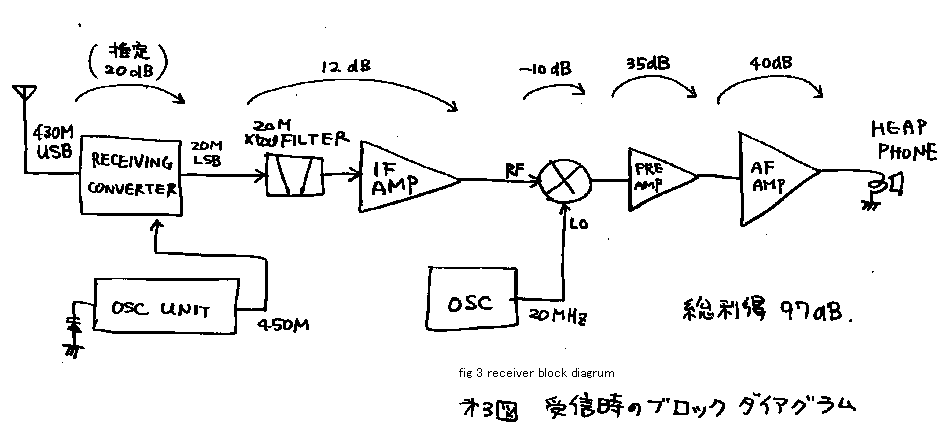

See fig 2! This is a diagram of transmitter. Audio signal is amplified by audio AMP. It is inserted to IF-port of the DBM. On the other hand local oscillator makes 19.9961-MHz signal. It is inserted on a local-port of DBM. Then I can receive 19.9961-DSB signal on the RF-port of DBM. See fig4! Only lower side band of DSB signal can pass through handmade-crystal filter. Therefore There comes LSB-signal on the exit of the crystal filter. This signal is amplified by IF-AMP. And it is inserted to the frequency converter. On the other hand, 14MHz VXO is constructed with the 42.222MHz named crystal. And it is multiplied 32 times. There comes 450MHz signal. At the converter 450MHz CW-signal and 19.9961MHz-LSB signal are mixed. There comes 430MHz-USB signal and 470MHz-LSB signal. Only 430MHz signal can passes through the 430MHz band pass filter. RF-AMP is only single stage. And after the signal passes through the BPF again, it goes to the antenna. And radiated from the antenna to the air. I will Explain about the receiver. See fig 3! The signal from the antenna passes through all each the circuits, as the counter direction from that of transmitter. Two oscillators continue to work in both timing of receive and transmit. Therefore I have no need to be afraid the changing of the frequency between receiving and transmitting. Originally, by the way of development , the transmitting-converter was used also as receive-converter. But the self oscillation has happened. Therefore I made FET-receive converter another from transmitting-converter. I can re-construct the transceiver easily, because it is constructed on the mother-board. The AF-AMP has 40dB-gain. The gain of it is enough to the microphone-AMP. But for the receiver, I need extra gain. Therefore I sat the pre-AMP. It gives me more 35dB-gain only while receive.

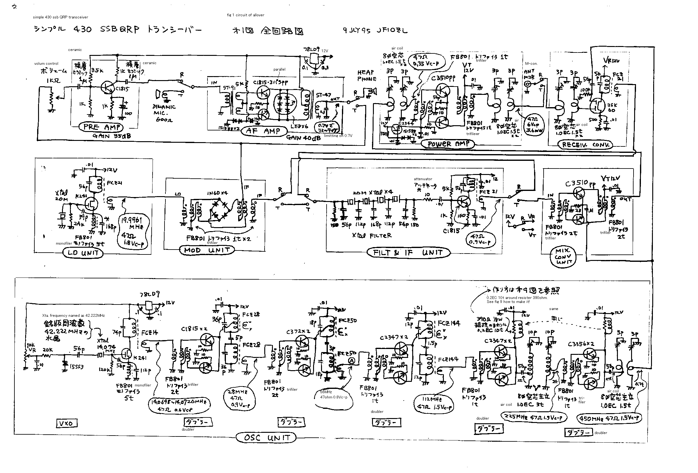

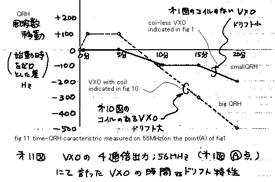

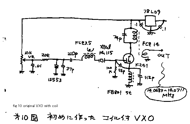

Oscillator is constructed by 14MHz-VXO and five times (doubler=) double multiplier. See fig 1. VXO is made of varicap-diode. I like to use a air-varicon(variable capacitor is called so in Japan). But in this machine, I use the varicap-diode. By using varicap-diode I can lay out the oscillator-unit and tuning-dial freely in the case. When I use a air-varicon, I must locate the air-varicon near from the local-oscillator unit. See fig 10! Originally oscillator was constructed by VXO using coil. Some operator send me the report that my signal has QRH. Therefore I changed the construction. I used the coil-less-VXO. See fig 11! Original-coil-VXO has 600Hz of QRH by 20 minutes. And the coil-less VXO is improved in this point. By this VXO transmitting-frequency is tunable from 430.2352 MHz to 430.3256MHz. I bought the 42.222MHz third overtone crystal by mail-order business and use it with it*s original frequency. The five-times-doubler is constructed by push-push doubler. I learn about this doubler in the ARRL-handbook. This type of doubler can work very sure. Because it works as C class amplifier, it has no possibility to make useless self oscillation. And this type of doubler can make very pure signal. Because it has double tuner on the corrector, it avoid to through the original frequency, it avoid to product three harmonic frequency. Yes you can believe it is the double frequency signal if you can get some signal on the output of this circuit. I do not have a spectrum analyzer, therefore I must choice such a reliable and easy to tune circuit. I want to say one more this type of doubler is free from miss tuning. ....Five doubler is constructed by the same circuit. But the dealing frequency is different from each other. I must choose the transistor to match the frequency.

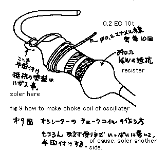

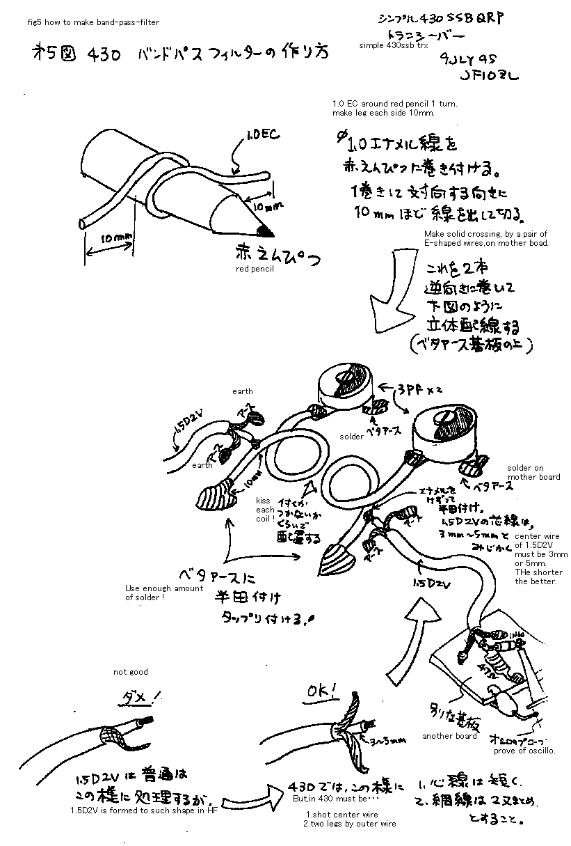

In the UHF circuit, the leg of the parts must be made very short, else you meet the self-oscillation or lack of output-power. See fig5! It indicates how to make 430 MHz band-pass-filter. In this filter, if you lay each coils more closely, you can get more power. But too close lay out gives the poor filtering character. If you take some space from each other, you can get cleaner signal from it. But too much distance gives you poor signal strength. Therefore, you must adjust the combine-factor of this band pass filter. In order to tune the connection factor , solder the 1.5D2V(Japanese industrial standard calls so) coxial cable wire on the coil. And on the other side of the cable, join the dummy load and 1N60 diode and the prove of oscilloscope. If you joint the dummy-load and the prove directly on the side of the band-pass-filter-coil, the electro-magnetic force of 430MHz makes the influence to the prove of oscilloscope and you can not measure correctly.

Audio-frequency-amplifier is constructed by a normal transducer-push-pull-amplifier. Three-series LED is connected on the first side of trans. The LED begin to brink when it*s voltage becomes over 2 volts. Therefore it can limit the voltage with 2 volts. Therefore this three LED array limits the voltage amplitude on the first side of the output transformer with 6Vp-p. If you use more LED , limiting point becomes bigger. When I speak to my microphone the LED lights. It indicates this limiter makes it's job then.
....Local oscillator unit ...
I must use the five 20MHz crystals to built this gear. Four of them is used for filter. One of them is used for the local oscillator. See fig4! At first I made a filter. And I tried some types of oscillator to make suitable 19.9961 MHz signal. FET-COLPITS-oscillator is used for the purpose. You must adjust the capacitor between source and ground to get the suitable frequency. By this method you can make SSB-signal with a set of 5 the same crystals.
....modulator unit ...
Modulator unit is made by diode-ring-modulator. You must limit the audio signal smaller than half(-6dB) of the carrier signal. Else DSB signal becomes dirty.

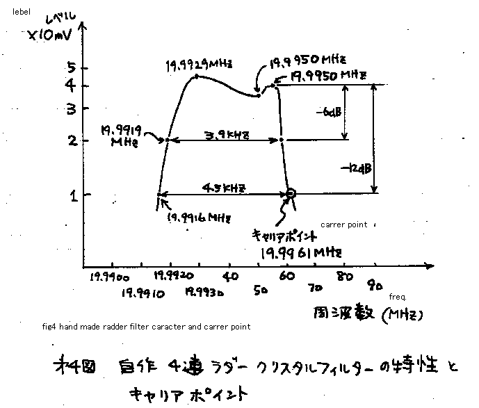

....ladder type crystal filter ...

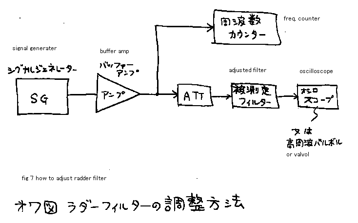

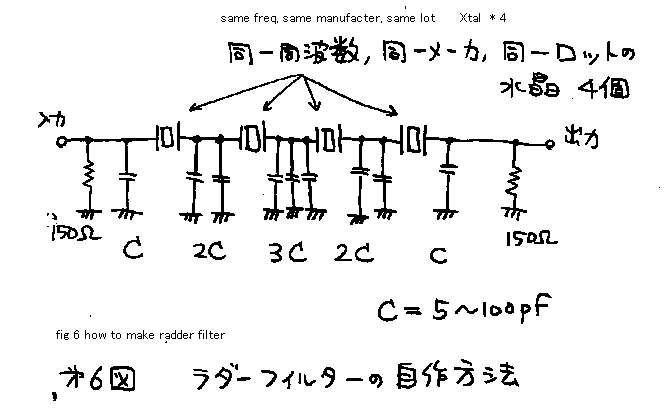

See fig 6! Join four the same crystals series. And join the nine same capacitors between the crystals and the ground. The capacitor becomes bigger , narrower the pass band becomes. But you cannot change the center of pass band. It is decided by the original frequency of the crystal. Put the attenuator of resister on the front and end of the filter. Else shape of pass band becomes bad. This filter has the loss about 10dB. So you must use IF AMP after it, to cover the loss of the signal. See fig 7! It indicates how to adjust the filter. You can plot the characteristic of the filter by this system. If the pass band is wider than 4KHz, change the capacitors for bigger one. And try again. If the band pass is narrower than 2.5KHz , change the capacitors to smaller one. It may need 6 hours to make this adjustment with this signal oscillator and frequency counter.
If the filter is narrower than 2KHz your transmitting-voice may become like nose-closed-person, because the upper half of your voice be cut. If the filter is wider than 5KHz, your rig may have QRM on the crowded band , because the filter can pass the neighbor side signal. Therefore the pass band of the filter should be adjusted between 2.5 to 4KHz.

Converter is constructed by the push-pull-active-single-balanced-mixer. Also in the case of this mixer, the IF signal must be smaller (lower signal strength level) than the local signal. Therefore I put the 10-ohm-resister in front of the IF AMP. In stead of this tuning, you can add one more amplifier on the local oscillator. It is a matter of total signal revel planning as the transmitter. ............I will explain about the tuning of emitter resister of the converter. The smaller resister if you use, the conversion-gain becomes bigger. But it may need more power as the local signal. The bigger the resister if you use ,the smaller level of the oscillator can drive satisfactory this converter. But the conversion gain become small in this case. In this machine I made, the conversion gain becomes -8dB. Its loss is smaller than diode converter. But the conversion gain is far smaller than the normal nallow band converter. In this converter you must use high ft-transistor. I use 2sc3510(ft=3500MHz). See fig 8. Emitter-base-collector are printed on the package of this transistor. I guess the designer of this transistor (Technika of Hitachi) may be kind person.HiHi
... power AMP ....

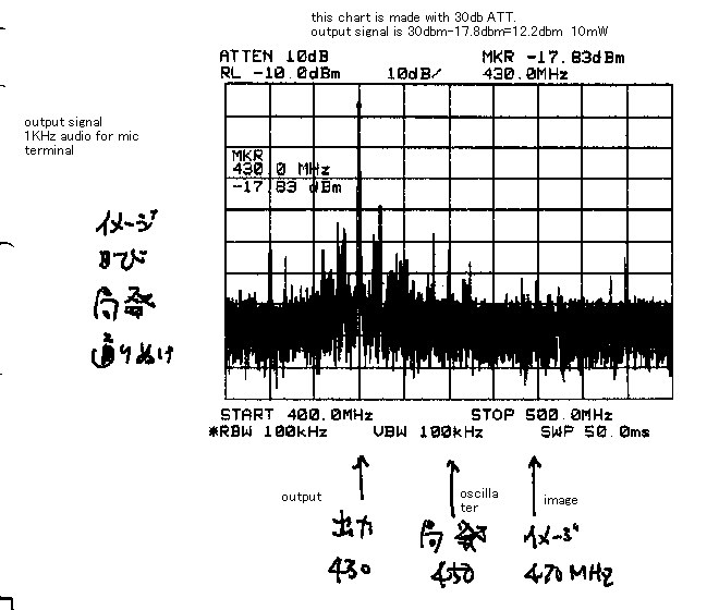

Power AMP is constructed by the wide-band-push-pull-A-class AMP. This type products very clean signal. But ft of the transistor must be bigger than ten times of 430MHz. Output-power of AMP is 10mW QRPP. Please look the last figure of this page. I measured the total transmitting signal frequency character with spectrum analizer of Japanese amateur radio association. The through of local signal 350MHz , and the difference side of the converter 470MHz is suppressed 40dB or more than the transmitting signal of 430MHz.

In the receiver, all the circuit is used as the counter direction from the transmitter. All the circuits is changed by small relay. Only the front converter of the receiver is constructed by two gate FET. It is normal usage of this FET, that is developed to use the front converter of TV receiver set.

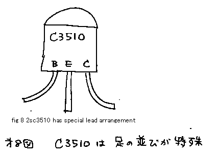

2SC3510: Maker= Hitachi: usage UHF ,VHF amplifier: Vcbo=20V: IcMAX=50mA: PcMAX=600mW: hfe=30 to200: fT=3500MHz: Typical 10.5dB on 900MHz

Original VXO with coil

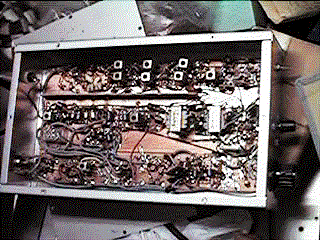

View of whole this transceiver without top cover
