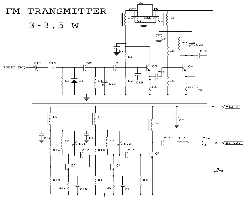

This is a circuit that I've build a few years ago for a friend, who used it in combination with the BLY88 amplifier to obtain 20 W output power. From the notes that I made at the original schematic, it worked fine with a SWR of 1 : 1.05 (quite normal at my place with my antenna).
Schematic:

2. Q1 and Q5 should be cooled with a heat sink. The case-pin of Q4 should be grounded.
3. C24 is for the
frequency adjustment. The other trimmers must be adjusted to maximum output
power with minimum SWR and input current.
