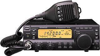

As small as it is, the TS-50S packs a powerful punch. Maximum output is
100 W, and there is an impressive range of features -- including 100 memory
channels, DDS with innovative step logic control, and AIP for superior dynamic
range. IF shift and CW reverse mode help reduce interference, while TF-SET
facilitates split-frequency operations. Ensuring user-friendly operation
on the move is a convenient menu system, which can also be accessed via
the multi-function microphone. And there are several attractive options
available to make the TS-50S even more versatile.

The TS-50S is similar to our other VHF mobile transceivers in more than
just looks: this HF rig is compatible with remote-control microphones featuring
4 programmable function keys.
