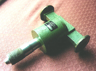

You
might have access to an accurate frequency counter..use it! You may also be
able to obtain an X Band wavemeter at hamfests or radio rallies. The one pictured
here was bought for only Ј10 UK (about $16 US) and was indispensible to writer
in his "early days". This type of wavemeter, with waveguide ports
is easy to use. Tuning the micrometer dial will cause a "suck out"
or dip in mixer diode current when the frequency of the Gunn coincides
with that of the micrometer cavity. Ideally you should have a microwave detector
diode mounted in a waveguide cavity and place this after the wavemeter. In other
words, the wavemeter should be put between the Gunn oscillator and the diode
receiver. Sometimes the flanges may not match the ones on your Gunn transceiver.
You will then need a short length (say 6cm) of waveguide with a round
flange at one end and a rectangular one at the other for use as an adapter.

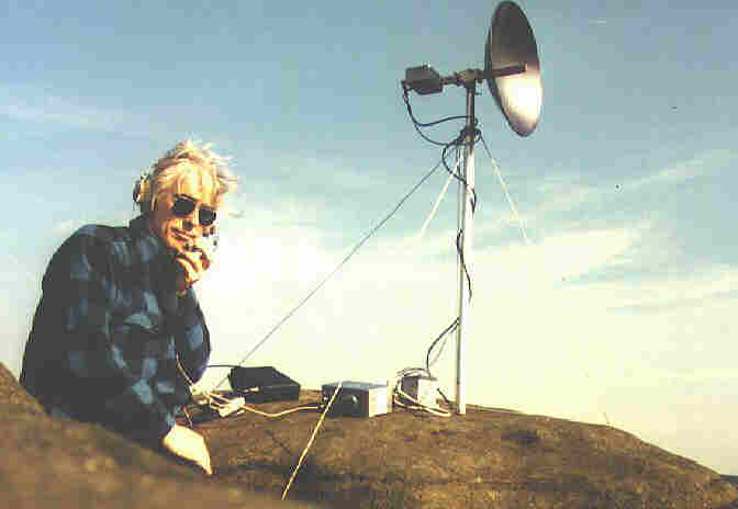

The photograph on the right shows
G3PHO/P,
in the summer of 1985, working over a 160km path on 10GHz wideband.
The Gunn transceiver is split into two separate units.... on the short mast
is the Gunn oscillator and diode mixer "head", feeding a small 20
inch diameter dish. On the rock below you can see the power supply/modulator/tone
oscillator and 30MHz receiver unit. The modulated Gunn voltage is fed
up to the microwave head via a short cable while a length of 50 ohm coaxial
line brings the 30MHz IF signal back to the unit below. A 30MHz preamplifier
is fitted into the head unit to provide a good match and sufficient signal to
the IF unit below. The measured Noise Figure of this system was around
8dB, quite good for a diode mixer! (Modern, narrowband 10GHz equipment is now
commonly found with Noise Figures around 1 to 2dB). To the immediate right of
G3PHO is an IC202S ssb/cw handheld transceiver for 144MHz. This was used to
established talkback. The 3 watts p.e.p and quarter wave whip antenna of the
IC202S was generally adequate over line of sight paths such as these.
This type of simple microwave and talkback gear was easy to carry up to the top of Britain's highest mountains. As narrowband has taken over from wideband as the preferred mode of operation in Europe and the UK, higher and higher power levels plus bigger and bigger antennas have become the norm for the 144MHz talkback. G3PHO/P now has to use nearly 100 watts p.e.p to an 8 element DL6WU design yagi. The 5 amp dryfit, gel battery has given way to a couple of 80 amperehour lead acid types...hardly backpack portable any more! If you build the simple wideband gear of the "old days" you can really enjoy yourself in the Great Outdoors..provided you have a like-minded friend or group of friends.
